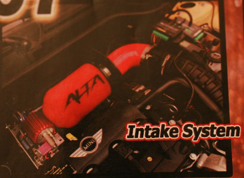

Beek is sinds kort inderdaad dealer van Alta. Voor sommige mensen misschien interessant
De luchtfilter komt over 3 weken zeggen ze:

INTAKE SYSTEM TESTING BEGINS……….
Our initial test of the intake system was done with the OEM hood scoop left in place. Our intake is designed to remove this, but we wanted to prove how this was a necessary mod. So we did 3 quick runs with the scoop on and 4 quick runs with the scoop off. Below are the runs, with the strange low boost runs removed. The dyno’s runs are redrawn over with a wide brush to show the average of the 2 runs. With no scoop, the filter temps constantly climbed. In 3 quick (10 second interval) runs, the temps were at 150 degrees. With the scoop removed, an instant 30F drop occurred, and a constantly cooling temp change started. The next 3 quick runs showed a nice change in both temp and Wheel HP. The gain was somewhat expected, and the scoop needed to be removed to get the most from the intake system.
Above graph shows averaged runs with and with the scoop being blocked.
So where is the “complete” cold air intake?? The feasibility for a cold air intake is never out of the question, but the cost is the issue here. We wanted to bring the best bang for the buck to the plate first, not scare people away. Since our intake did so well in its form you see here we will continue with developing it this way. Plus we have some things up our sleeves to make it even better.
On a side note, when dealing with MAF (Mass Air Flow) sensors, small changes to turbulence in the intake system, can make huge changes to how the car runs. Because we are familiar with this problem on other cars, great care was taken to eliminate any turbulence issues that might throw a CEL, or make the car run too lean or rich. We can say for a fact that our intake replicates the stock MAF curve nearly perfectly!
Above graph shows averaged runs with and with the scoop opened up and intake installed!
